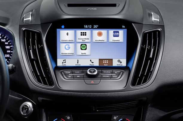

Works with all versions. Will update any sync to 3.3
What's the problem?
US navs have less space than EU versions of the same so you're not able to install EU maps without this hack.
